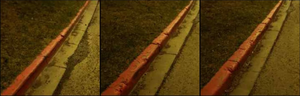

This model (below) was projected using these 3 images all shot from the same perspective moving forward a few feet between (with a cellphone camera at night). Total capture to render time ~10 min

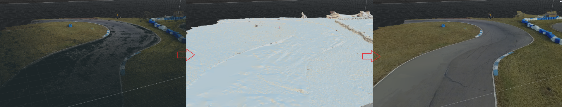

This one was "extracted" from ~150 keyframes from the first 18s of Michael DeCnodder video https://www.youtube.com/watch?v=zZebYGEokQE and required lots of masking to the source images. The holes in the first pictures mesh is due to only having one flight direction and not purposefully taken photos with a sharper downward angle, the camera looks across the horizon and in recreation this also leads to skewing of the alignment making holes.
After I masked out the sky and horizon portions of the source images I was able to reduce the skew from the single flight angle substantially

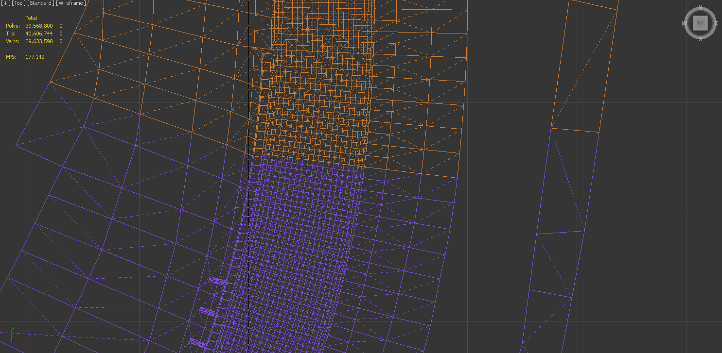

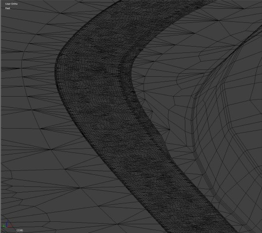

*edit2* The further down the rabbit hole I get, the more I think I'll leave the rFactor implementation to the KartSim team if they have intent to scan western Canada's tracks. The scope of work required taking the 3D model generated from photogrammetry into the game's engine is a bit more daunting that initially anticipated. The conventions for preparing the model are quite a bit different, rFactor2 is suited to using LiDAR point cloud data and that only contains the color of the points, not the texture or colors in between, textures have to be made and applied manually and that's where most of the "look" comes from. Photogrammetry you can think of like a less accurate liDAR point cloud it too contains the point colors, but it also has the picture data to fill in all the in between and generate photorealistic textures that I'd never be capable of recreating.
In Assetto Corsa on properly made tracks the roads you see visually have no collision and are not what you're actually driving on, they are a low polygon mesh with high detailed textures. Less polygons rendered directly relates to framerate performance. What you are actually driving on is an invisible copy of the physical road with a very high polygon count and that is where the force feed back detail is derived from.
rFactor2 the road you visually see is the one you drive on. From a photogrammetry standpoint rFactor2's workflow complicates modifying the road, adding bumps, or tweaking FFB by manipulating visual and physical at the same time.

Assetto Corsa - Visual mesh
Assetto Corsa - 'Phyiscal' or driving mesh
rFactor2 Single Visual&Physical mesh
