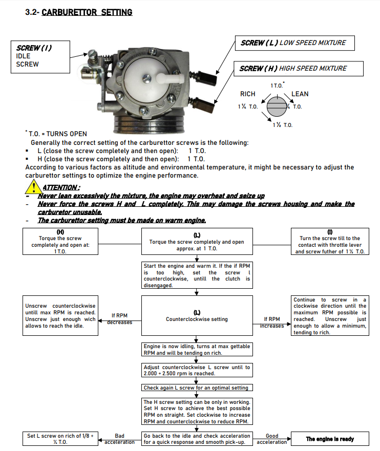

• Settings are generally measured in Turn outs (T.O) or "minutes"
• Factory settings at 1TO on High and Low
• For the most part you should not need to adjust these on track unless you have experience doing so.
• Recommendation to have a carb pop-off gauge to test periodically and after service

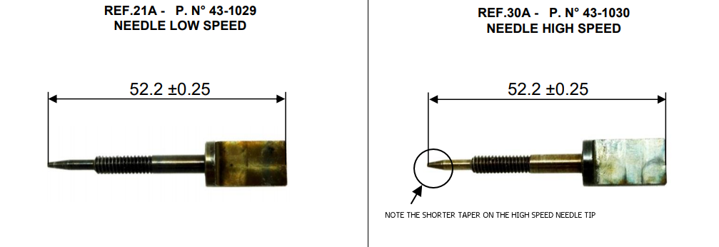

• If you run your carb through a cleaner and remove the needles. The low speed needle is the one with the longer tapered point
