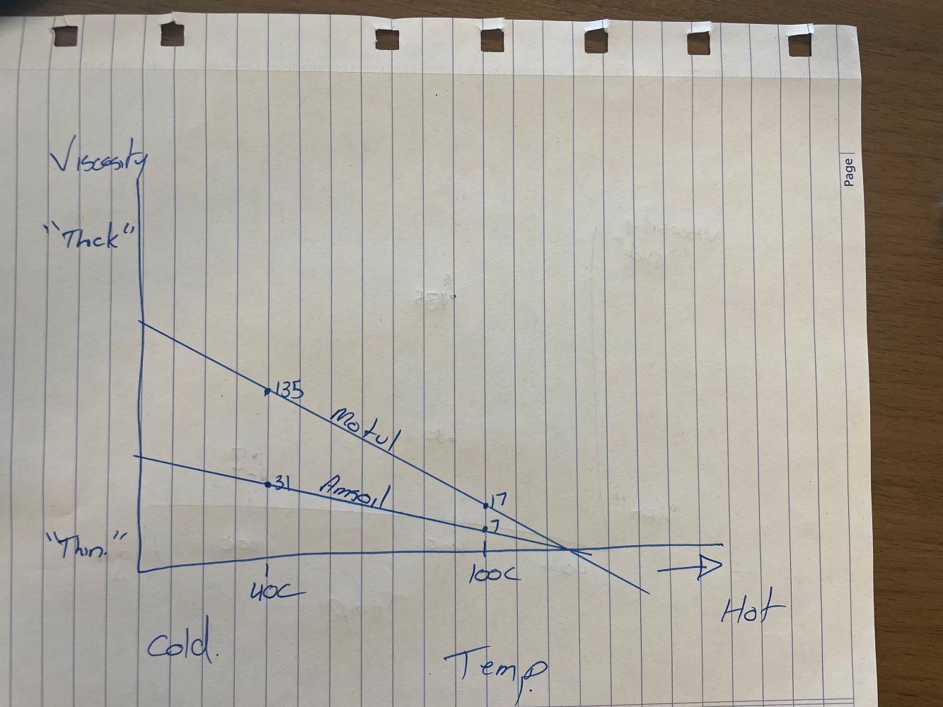

Flash point indicates the temperature, above which there is enough vapour created by the substance to ignite (The temp. above which a lit match becomes a danger). Gasoline's is about -40C, so will ignite just about any time. Diesel is about 40C, so if you drop a match into diesel, it extinguishes.
Flash point, at best, is a poor indication of high-temp protection as it doesn't suggest what has evaporated, what remains as a liquid, or how much of either has happened.What is of more value are the viscosity at 100C and viscosity index of the lubricants.
Were you able to find a spec sheet for the Rotax oil? I could not, but found info for Motul and Amsoil, and would say that if you’re concerned about high temp protection, Amsoil seems a better choice. I've attached a graph, while not to scale, illustrates this.
The relevant available numbers are the viscosity at 40C and 100C and viscosity index.
When looking at the two oils, the Motul is 'thicker' at both 40C and 100C than the Amsoil, so one might suggest that it provides better protection throughout. The problem is the rate of decline of the viscosity through that heat range. The Motul has dropped 118 points, while the Amsoil has dropped 1/5 that amount. The Amsoil is dramatically better at retaining viscosity under temperature - which is shown in the higher (better) viscosity index number for the Amsoil.
If you draw the line of viscosity for an oil through the temp range, the line is straight (the viscosity on the Y-axis is logarithmic, so 60 isn't twice as high up as 30, for example). What this means is that the two lines intersect soon after 100C, and the Amsoil will be more viscous at high temperatures than the Motul. I'd love to see the numbers for the Rotax oil, if anyone can find them.
Amsoil Motul
Viscosity @40C 30.7 135
Viscosity @100C 6.5 16.9
Viscosity index 172 136
The effect of temperature on oil viscosity is very poorly understood. A few years ago, I had someone at the dealership argue with me when I asked them to put 0W oil in my car. He told me it didn't provide adequate protection vs. the 5W they wanted to use because it was a 'thinner' oil. The thing is, it's only thinner when it's cold (which is what one wants to get the oil flowing through the engine more quickly). The first number in a multi-weight oil denotes the cold-temp viscosity and the second the high-temp viscosity. A 0W40 and 10W40 oil will both have a similar viscosity at 100C (because they are both 40s), but the 0W will be much thinner when cold (good) and thicker above 100C (good), as the lines intersect.
In short, if available, ALWAYS USE THE 0W GRADE OF MOTOR OIL FOR YOUR CAR.

- viscosity.jpg (171.31 KiB) Viewed 24982 times
